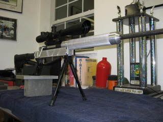

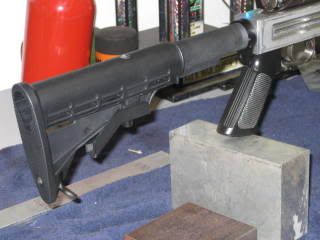

This is the first of hopefully many posts on this forum, I have been trying to find a forum that would allow me to post info and pics of my latest project, the other forums don't like people the butcher up guns. I have had a Mosin Nagant for 20 years tucked away in a closet and decided to build a custom gun with it. I have an AR-15 and I like the look so this influenced my design. I relocated the bolt lever and reshaped the trigger housing. Made a pistol grip and M4 stock conversion. The gun barrel has had 9 inches taken off and I recrowned it. I'm not finished yet and some of the parts are still prototypes but I hope to have it completed in the next week. Anyways here are some pics.
[IMG][/IMG]
[IMG][/IMG]
Relocated bolt
[IMG][/IMG]
[IMG][/IMG]
M4 stock conversion
I'll post some more pics as long as there is an interest, Thanks, Bryan

The scope is going to be mounted on two small risers that will be mounted atop the receiver. The rear mount actually bridges the area where the stripper clip would be inserted, this is why I relocated the bolt. I haven't finished the mounts and the scope in the pics is basically just mocked up in place.
Bryan

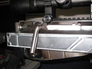

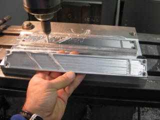

Well today I did a few changes to the project, 1st I redesigned the side covers. I wasn't real happy with the 1st set. Here is a pic of the second set
[IMG]
[/IMG] Here is the pic of the parts coming off the mill.
[IMG][/IMG]

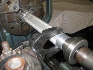

Here is a pic of the current look, I knurled the hand guard
[IMG][/IMG]
Here is a pic of the knurling process on the lathe.
[IMG][/IMG]

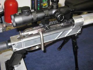

Another pic of the side.
[IMG][/IMG]
And last, this is for some reason my favorite picture.
[IMG][/IMG]

Today I made a new bolt handle and did a few mods to angle it back for a sporter style look.
Then I welded and finished it out. Here are a few pics.
[IMG][/IMG]
This was the beginning after I relocated the bolt handle.
[IMG][/IMG]
This is the finish product.
[IMG][/IMG]

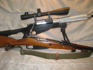

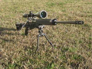

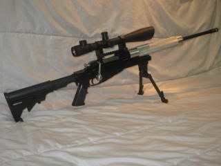

Today I finally got to finish up the Mosin. I machined up the mounts for the scope and welded them to the receiver, then I made the bipod mount and finished all the other loose ends. Here are the final pics.
[IMG][/IMG]
[IMG][/IMG]
[IMG][/IMG]
Not bad for a 1928 Mosin Rifle..
[IMG][/IMG]
Here I have my m44 carbine version along with the modified example you can see how I changed the bolt location for my scope mount design. I plan on a trip to the range to sight in the scope and see how well it shoots. I'll post the results.

It is a beautiful piece of work. By all means, let us know how it shoots. I have a 91/30, completely unmodified, that will easily shoot 2" groups at 100 yards off the bench with milsurp ammo, so I know darned well the action and barrel are capable of fine accuracy.

The rifle weighs 12 pounds as opposed to the stock 10. I may do a little machining to the inside of the side covers to shave off some more weight.
