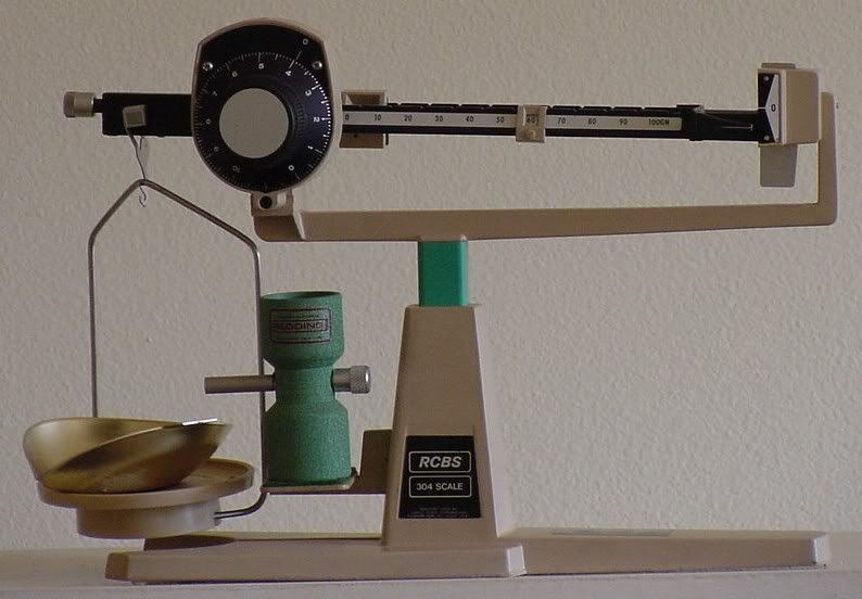

You asked about a scale. This is my balance beam scale. It is no longer marketed but is quite handy. I suggested before that I can't recommend a "kit" because there are so many good equipment choices that allow you to mix and match to your specific style of reloading.

Nice photos - Thanks. I have Lee "Classic" press envy. I agree with you that the "kits" may not be the best way to go. I bought two kits, a Lee single stage and a 4 hole turret kit - but as far as I know Lee did not make the "Classic" presses when I bought my kits so I really have no regrets. They work just fine. We essentially use the exact same reloading method except I really like to use the hand held Auto-Prime. Otherwise we are on the same page.

Thank you much, Flashhole, for the pictures. Looks like you have an awfully good setup there.
