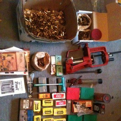

but anyways.....i just got this stuff for christmas from my mother....it was my father reloading equipment...to bad he isnt here now to show me how to use it but im studying and super excited to learn the art!
that box is a third of the way full with .44 brass....i almost want to get another model 94...like a trapper in .44 cal. i already own a .44, it was my fathers also. its a huge virginia dragoon revolver, really cool has a scope that mounts on it, but i like lever guns.
the press is a hornady pro-7. i got shell plates for the 44, 30-30, and 380 auto....looks like its impossible to find parts for this thing.....so will the shell plate for the 30-30 work for my .32? if it wont im going to have to buy a new press....and just use thing for the .44 and 380. if anyone has any of these plates for sale, pm me please! im tinkering around with it the manual is long gone but there are several books on reloading im reading now....but im kinda just playing it by ear figuring out how this old thing works....its a little rusty...took some work to free up the hopper....still havent freed up the press though.... im sure it will come around....if anyone on here uses one of these and knows how to set it up, some tips/info would be cool!

The .32 Winchester special and the 30-30 use the same shell plate.The .32 is basically a .30 caliber case necked up to .32,
Stan in SC
