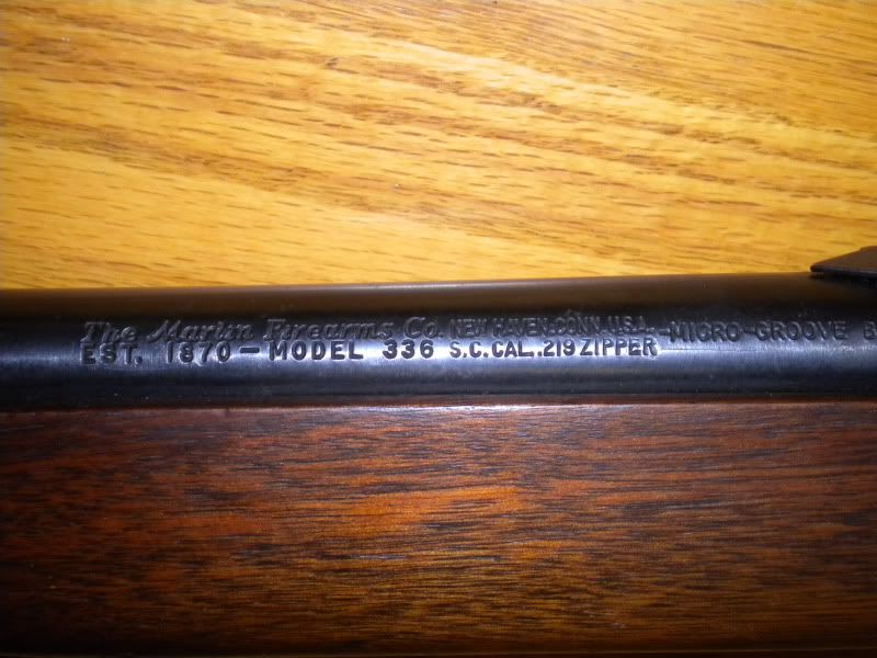

Took me 8 years of searching to find a Marlin 336sc Zipper.They were made from 1955-1960 and they only made 3230 of them.The first year they had a standard diameter barrel.In 1956 the barrel diameter was increased by 1/10" for better accuracy.They all had 20" length and Microgroove rifling.They failed at that time in the marketplace but have become quite valuable in the collector market in the last 10 years.I would not bother with the expensive original ammo as that is collectable.For handloading buy new Win 25-35 brass.Lube it and run it thru the 219 resizer die and trim it back to a length of 1.928" .You will notice a slight imperfection in the shoulder area due to the differing taper between 219 and 25-35 but not to worry as it will fireform out.I found I have to trim after each firing for a few times before things settle into place.IMR 4320 works well,but I found the best accuracy in my rifle with H4198 and a Sierra 60gr HP bullet.I have shot a 3 shot group at 100yd of 5/8" with it.I place one in the chamber and one in the tube.(I knew what some people would think)Brass can be formed from 30-30 with much more effort and you will likely have to turn down the necks.
L-R 219Z,25-35,32spl,32-40
