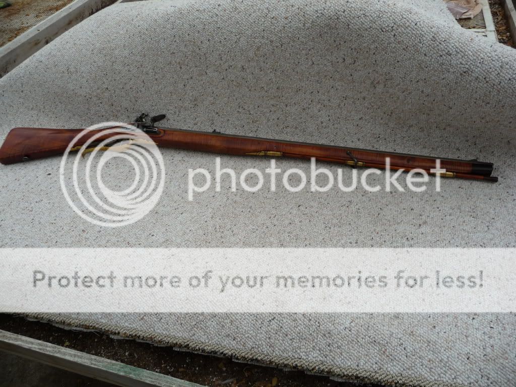

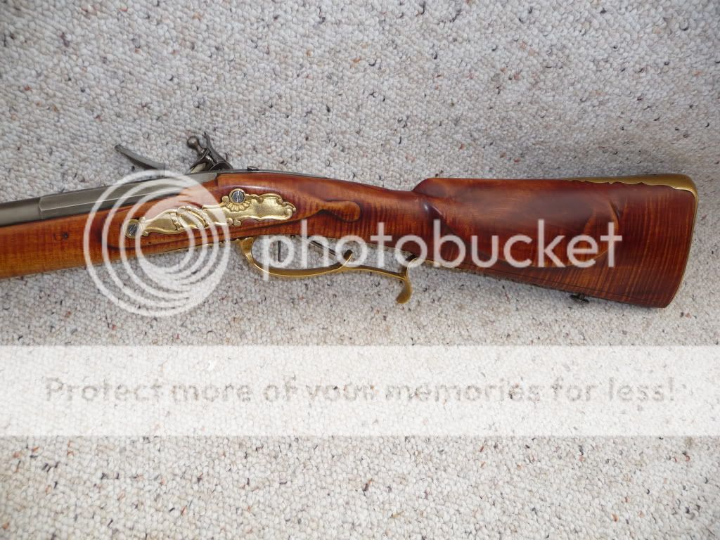

My Idea of a Transitional American Longrifle
I like the shorter jaeger style rifle for getting around in the thick brush near my home. I had once owned a fullstock Hawken style flinter that really fit me well. It would shoulder with my line of sight all in one quick motion. Problem was the weight. That rifle weighed around 12 lbs and after a few hours in the woods it became quite a chore. I decided to build a lighter, shorter rifle utilizing the buttstock pattern\profile of the Hawken. I considered the Germanic early style in my planning, but only had access to maple for the stock wood. Bought a very nice oct to round 50 cal. tappered 34" barrel from Mark DeHass and a large Siler flintlock from Jim Chambers. I also went with jaeger double set triggers and Germanic brass furniture. This is what I ended up with. It is now my favorite all purpose hunting and target rifle. [IMG][/IMG] [IMG][/IMG]

Nice looking rifle there!
This one here is not really a transitional rifle and was built in 1810. Did you see it yet?

So Captjoel, what does that little beauty weigh? I'd guess that tapered round barrel would come in pretty light, maybe 7 or 71/2 pounds? Nice "mountain rifle" in the modern sense of that term.

Ahh, very fine German flintlocks! There is a rifle pictured in George Shumway's book "Jaegers" made by one of the Pistor family members. Could be the same guy who made this example. CoyoteJoe, my rifle weighs just a hair under 8 lbs. It is more from the wide butt than it is the barrel wt. I made an adjustable sling for this one and it really helps to take the "load" off! I have to share with you fine fellow's my love for the traditional muzzle loading rifle\fowler. My wife calls it my obsession! I don't know what I like better, contemporary, original, Kentucky, German, flintlock, or percussion, it's all fun stuff. That black powder sure does get into your blood stream!
