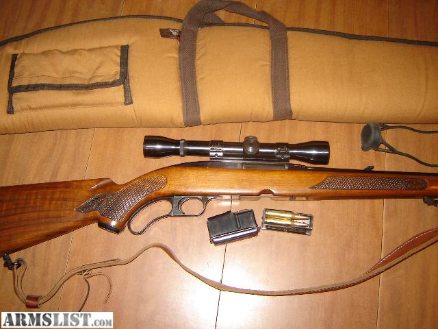

Will a 220 grs Sierra or Hornady RN bullet stabilize in a 308 WCF Model 88 Winchester?
Pete
...don't count out lever guns such as the Winchester Model 88. This rig, chambered to .308 Win, will handle nearly any deer situation.
