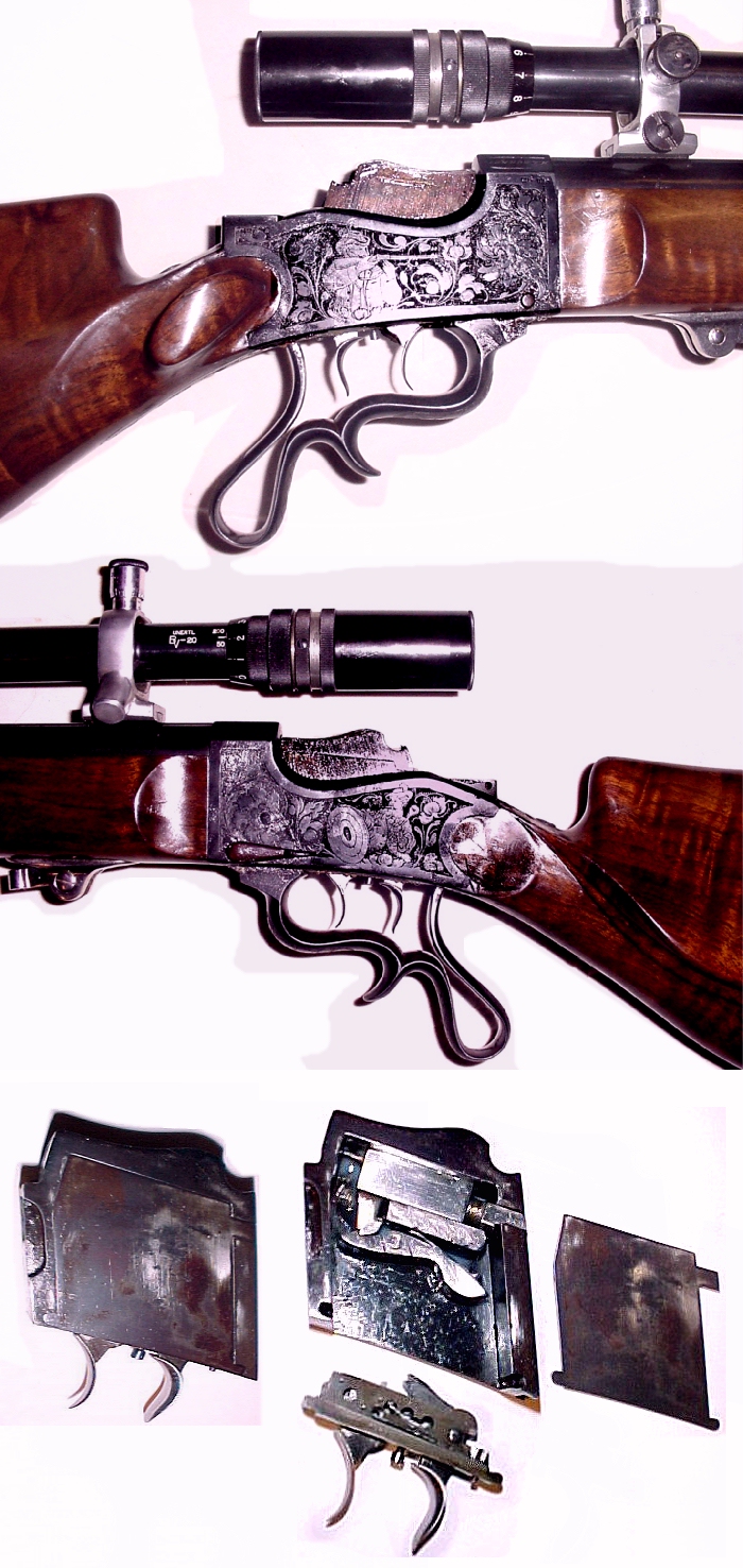

Here are differently actioned rifles by the same maker (Buchel) as the OP's:

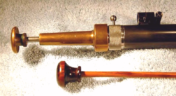

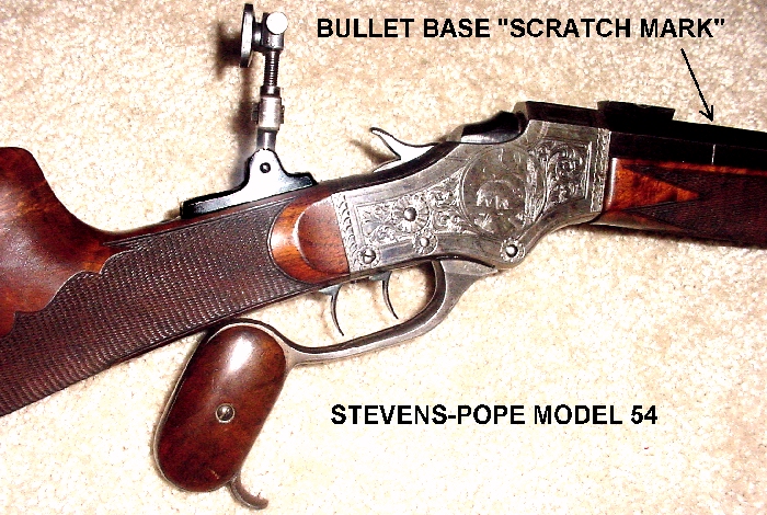

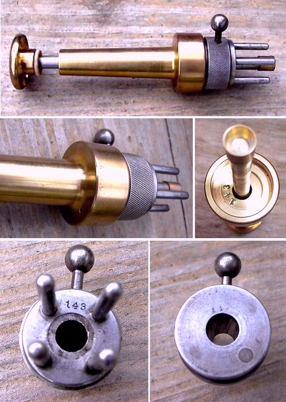

The barrel would have originally had a "false muzzle / bullet starter" with it. Here is what they look like from one of my Pope rifles. After starting the bullet down the muzzlle, a matching wooden rod of proper length would be used to push the bullet to a final position just ahead of the case mouth.
If you look at the right side of the barrel on your rifle (about at the cartridge mouth location) you will find a "scratch mark" that is the desired location of the bullet base.
The rod length would be matched to the desired bullet so that the base was at the exact position of the mark.

by the way ... your rifle's action is a true "Lechner" with the trigger assembly in the bottom of the breech block. (it is removable through an access cover - left side on your rifle)
That feature is "unique" to the Lechner.
