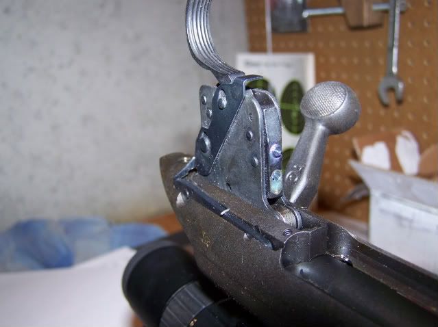

I recently brought home a Rem Mod 700 SPS 243 Win. I used Bob's excellent instructions to adjust the trigger. Have to say, the Win Mod 70 trigger is much more pleasurable to adjust!
When I first took the stock off of the Rem Mod 700 and looked at the trigger, I thought that Rem must have enclosed everything and made it non-adjustable. But then my aging eyes were finally able to focus on those itty-bitty screws! Here's a pic that might help those like me that have never tackled a Rem trigger before.
I didn't even have a flathead driver in my gunsmithing driver set small enough and had to dig out a watch/eyeglass screwdriver set. The factory sealant came off fine, but only the two front screws would break loose. I didn't want to bugger the slot, so ended up only adjusting the trigger pull screw. Ran through all the tests slamming the bolt, trigger pull on safety, releasing the safety, and the trigger seems at about 3 lbs, and I can't detect any creep. It didn't need much adjustment really. And the best part....using the glitter nail polish really dresses up your rifle. That's all I had (the stepdaughter had) since I never had a use for nail polish before.
Thx for the help Bob!

I broke down my 700ADL yersday and adjusted the trigger pull screw. I didn;t mess with the sear adjustment as another member said his trigger action locked up with any adjust ment of the screw. I also didn;t adjust the overtravel.
Anyway, it was easy using a dental pick to get the locktight out of the allen head and around the head. Once I found the right size allen wrench, the screw didn;t even "break" free.....it just turned nice and smooth. All in all, I think I turned it out about one full turn, and it made quite a difference! I did the safety checks. If I had to guess, I'd say the trigger was set at about 4 pounds right now...just guessing....I might want to go a little lighter. I haven;t locked the screw yet because I want to try it at the range first.

The 700 triggers are notoriously bad. Yes a eyeglass type screwdriver will cut it thu the gummy bear glue that is on the scew holes. I turned mine out about one turn counterclockwise and it made a nice difference on the the pull of a tough trigger.

My Win 223 was purchased in 1998 & just started releasing the firing pin unexpectedly. If I push the trigger forward with heavy force, the trigger pull is 2 1/8 to 2 5/8 lb. If only light force, the pull is only 8 oz. It did not shoot very accurately until I had the recoil lug re-bedded a couple years ago.
I hate to remove the stock until I have proper adjusting procedure. I have removed the trigger guard looking for adjusting points. I read your adjusting procedure for Win Model 70, but the explanation of some parts is different than what I saw in my rifle. Is your procedure for a sporting rifle? Is the trigger mechanisms the same for a sporting rifle & a varmint rifle? The owner information booklet does not get into trigger adjustment. I sure would appreciate any help you can supply. If you have something with photos that can be sent by e-mail, my address is: [email protected]
Thanks for your help.

The procedure should be the same for all M70's (at least before the new, FN winchesters from South Carolina) You'll have to take the action out of the stock to see the parts that need adjustment. Although, as a word of caution, the instructions above seem to take for granted that the trigger is working properly to begin with, yours is definately not.

As jb indicated, the trigger adjustments for your 1998 (when you purchased, but may be an earlier model) are still valid. If you 'removed the trigger guard' on this action, you have freed the action to be removed from the stock, which you have to do to adjust the trigger. Can you post pics of this rifle? I'm wondering if this is really a mod 70, from your description?
