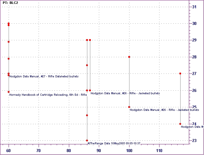

Additionally, in order to keep a sense of what pressures we were operating at, we found older data with pressures. The assumption being that: if a simple extruded grain produces x velocity with y pressure, more modern, more "degressive" powders should be able either reach a) the same velocity at a lower pressure, or b) a higher velocity at the same pressure. (Remember when Varget first came out and people were impressed with the velocities they could reach, without going over pressure...)
Beyond that, we also relied on the fact that the 25-35 had a good 50 year run, and although the data is dated, a consensus generally had been reached in terms of what was acceptable (in terms of pressure) and what was over pressure. We used those accepted max loads as our upper pressure landmarks... (and since we were using a 1:16 barrel, and the data was taken as "should be safe" in a 1:8 barrel, we took such as a little buffer in terms of pressure, ie, what's safe in a 1:8 should generate even lower pressure in a 1:16 (using the two IBPs we have access to: one suggests a 2600 CUP reduction in pressure, the other 4000 CUP)).

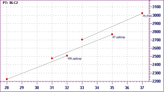

To make use of data for powders for which there was no data explicitly for a 86 or 87gr bullet, but was data for 60's, 75's and heavier, by plotting the data as acceptable PWs as a function of BW, one can interpolate the missing data.

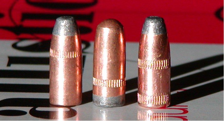

Why the 86gr Rem Softpoint to start with?
A couple of reasons: 1) we've have had quite a bit experience with the bullet in taking 25-20 data and 256 win mag data; and 2) for a first bullet for a new cartridge (in terms of data taking), why waste good money launching premium bullets, especially if one doesn't know if the loads will be worthwhile or not, ie, start with the bulk bullets, and then move to the Bergers etc. The previous experience is important in knowing how to judge a new cartridge, eg, a bullet that shoots .5 MOA in several cartridges, but in a test cartridge shoots 2 MOA - then one might know to start looking for a ballistics problem - without that knowledge it's harder to know what's a problem and what's "that's just the way it is".
Of note: the 86gr SP's we used were from the mid-1990's, ie, they were still with only the single crimp groove (positioned to make a 1.600 oal in a 25-20... since they were 25-20 bullets). As we got to the end of the data taking we were running short on bullets (after all these years - had been running on this stock of bullets for a decade) so ordered up a 1000 from Midway... only to discover that Rem has added a 2nd groove. Instead of mixing bullets within the data, we cut the 86gr data taking short. We have taken some data using the 2 groover, but are generally impressed that they are a lesser bullet, with a lower BC (likewise, they seem to seal less well generating less velocity for the same pressure).

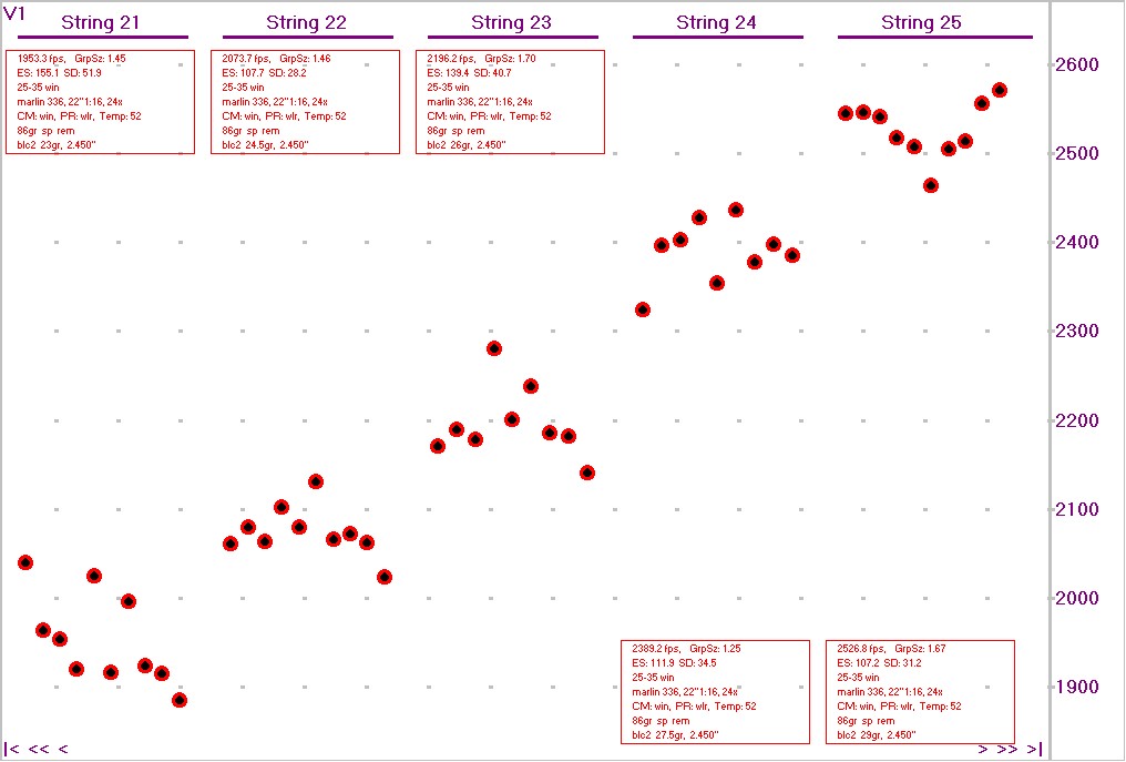

BLC2
3 GS < median, 1.25"-1.70", 0 SD < median. As a ball powder meters well (hey - had to say something good about it). Slower than i4046, runs out of case long before pressure.

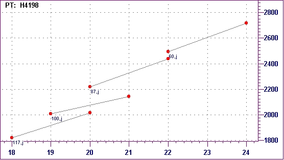

H4198
3 GS < median, 1.07"-1.79", 4 SD < median. Meters "ok". RL7, VVN130 class; good ignition, will look to for the lighter bullets later.

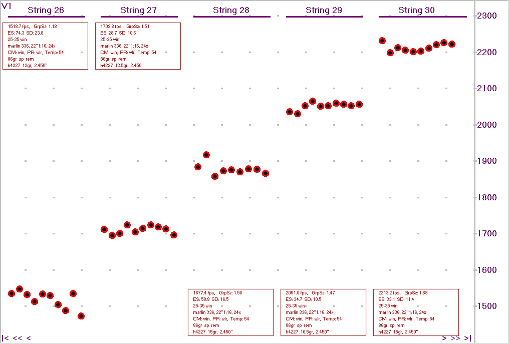

H4227
3 GS < median, 1.18"-1.89", 5 SD < median!! Meters well. VVN120 class, very good stats, should shoot better - will look to for forthcoming lighter bullets. A choice for low velocity loads.
