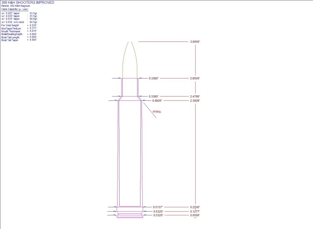

There is the 300 AI wildcat that is already a developed. cartridge.... I have a picture somewhere of the cartridge. If that doesn't do it for you I can use some software and do a design.
Here is what I would like to play around with...................

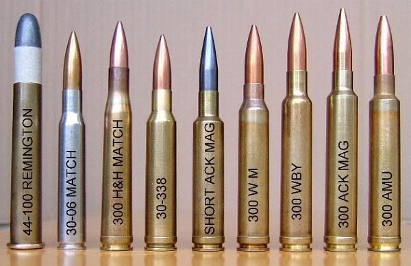

I think the introduction of the 300 Winchester Magnum as well as the 300 Weatherby Magnum put some wildcatting on the back burners..... still the 300 Ackley Magnum was a good cartridge.. the one I have done is an improved Winchester Magnum case, but then the 300 H&H as well as the Winchester are similar cases. Right now the changes I have made are showing velocities that beat the Weatherby... I am hoping to go far enough to actually get some cases made to my cartridge demensions so I can push it further.
I have one an improved version of the 300 win mag now that I have proven all the project notes are on my site venompublishing dot net.... I am getting a 333fps increase using a 200 grain Barnes bullet over the parent 300 Wincehster magnum... I am calling mine the 300 Venom Magnum Sniper, and it is ready to allow others to convert their 300 win mags if anyone is interested they can email me, and we can talk... intersesting idea... I have designed several wildcats using the Ruger cases... I am hoping to get one going soon.
