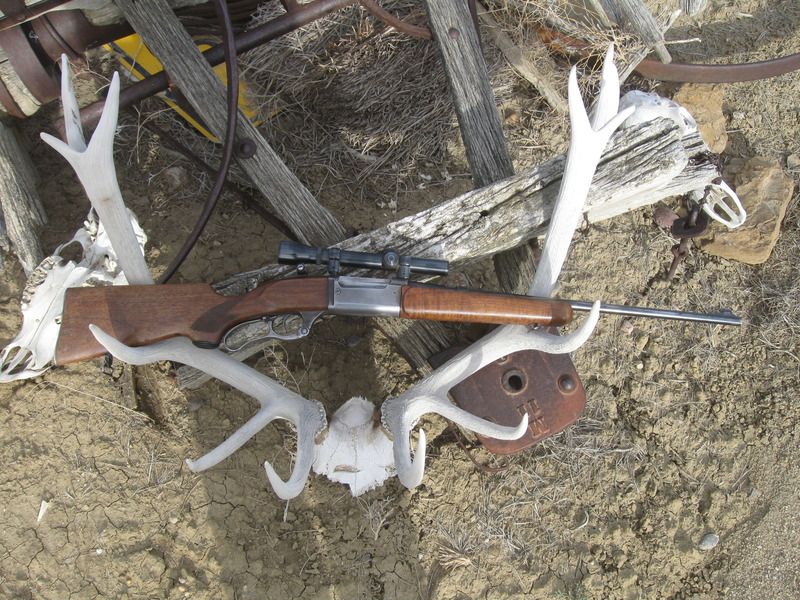

roseman, just to make you drool a bit :D
And M1 too!
Reactions: 3
That's something you probably no longer need. I'd be willing to discuss taking it off your hands.:D
And M1 too!
That's a sweet rig!
Love the 99!
