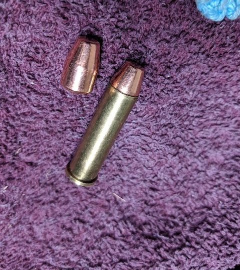

I've recently inherited some reloading supplies and I have a question. After you all provided me with a wealth of information and suggestions about my 45 ACP jamming I knew I was in the right place to keep asking more, even if I feel like I'm asking dumb questions sometime. I have a whole box of .38 FMJ 125gr FP bullets with no cannelure. I understand that my RCBS seater die is a roll crimp die and that I should only roll crimp cases onto bullets that have a cannelure. How can I put these bullets to use even if only for plinking, Is there a way I can load them for use in a .38 or .357 revolver with the die I have?
I have included a picture of a dummy round I made to test the effect a small amount of crimp would have.

Yes, you can use your die. Just back off on the roll crimp until it's barely rolling the rim over onto the bullet. A roll crimp isn't an "either/or" feature. It's adjustable all the way from none-too much.

If you're going to try to use them in a revolver like a .38 Spl, first make sure you have very good neck tension, and then apply a moderate taper crimp. Trying to use a roll crimp, even a light one, is likely to compromise neck tension. Be sure to seat and crimp in separate steps.
Another alternative is to obtain a canneluring tool and use it put put a cannelure on them. That will allow you to use a roll crimp without damaging the bullet or compromising neck tension. Its a nice tool to have on hand, and can be used for multiple calibers.

I doubt they'd move in a .357mag if any tension is applied to them. However, just use them in a 38Spl load and don't worry about them moving. It takes almost no neck tension/light crimp in 38Spl to keep them right where you put them. Load five or six and try them. I think for "plinking" loads you will have Zero problems using them. Buying a canneluring tool to try to use up a single box of bullets is a waste of time and money. I've shot countless thousands of .357mag rounds out of a dozen guns over the years and to date I've NEVER had any bullets move in the case. I'm sure I could make that happen if I wanted to, but using any crimp at all has prevented it. What diameter are these bullets? The 38Super uses .356 diameter bullets. Measure them and see what they are. If they are .356", you're probably going to have an accuracy issue using them in a .357 revolver whether it's a .357mag or 38Spl. If they're .356" give them to someone who has a gun they can use them in.

they measure at .357" and are 125grain FMJ

From the pictures, those look like Berry's or Rainier Ballistics plated bullets. An FMJ wouldn't have that many little dents from handling/packaging. Either can be "lightly" roll crimped, say to just barely remove the bell . . . Just thinking out loud

I've loded many TMJ bullets like that in .357 or .38. Normally what I will do is remove the .358-357case expander and substitute a 9mm (.356-.355) case xpander (assuming old school 3 dies sets from the same maker).
The 9mm expander is normally both smaller (by a couple of 1/1000ths) and SHORTER, so the bullet is really firmly gripped by just the case once loaded. The crimp can be taper or a slight roll...it's pretty much just an aid to chambering.
Taper crimps are great at resisting the foces of compression (trying to jam the bullet down into the case) but revolvers are acting like inertial bullet pullers on all the cases in the cylinder (with the last one to be fired getting 5 "inertial taps").
With moderate to lite loads and faster powders, might not have an problems just the way you are. But when trying to get slow powder/high vel. loads to work well, it helps to get the whole case diameter into the act of holding the bullet.
