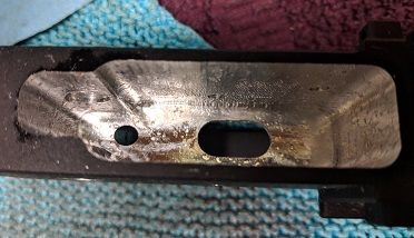

I started by drilling the pilot hole using the drill block as instructed and adding 3 drops of tap magic as I go periodically lifting the bit to clear shavings. I am using an inexpensive corded hand drill at half speed with light pressure and a steady hand. I know this step could be done easier with a drill press but I wanted to prove that with some patience I could do it by hand with good results. Keep it steady, straight, lubed, and smooth. Making sure the Jig stays aligned and level and secure in my vise. Once I have the pilot hole drilled I can then move in with the router. I start by setting the end mill bit to the first hash mark indicated in slot A on the Jig. I have found that speed setting 5 on the router works best for me. I spray a little WD40 onto the lower where I will mill and then position the router with the end mill bit fitting into the pilot hole. Once in the pilot hole I can turn on the router and carefully move it in a clockwise circular pattern to mill the opening, then turning off the router when I have finished a complete pass of the opening. Now I need to lower the end mill bit to the next hash mark indicated in slot A on the Jig. I found that lowering the end mill bit 3/64” at each step of the milling process worked best for me. This was easy to do with the router I used, I just had to rotate the adjusting ring 3 marks, each mark on the ring is 1/64”. I kept repeating this step by step milling process 3/64” at a time, very patiently and methodically for both slot A and slot B remembering to lubricate with WD40 on each pass. Chip management is a must through this process, the chips pile up fast and you need to keep clearing them out to see what you are doing at each interval. Don’t try to do too much too fast, slow and steady wins the day here. Keep a very firm grip on the router as it will want to jerk away from you if you don’t. It took me a little while longer than I anticipated to reach this point but I am happy with my results so far.
Now I just need to finish milling the oval trigger slot at the bottom of the pocket. I install the trigger template into the Jig and set my end mill bit to the first hash mark in Slot C on the Jig. Same as before I set the bit into the pilot hole, turn on the router, hold firm and move in a small clockwise circle then turn off the router when finished with the pass. Drop the bit another 3/64” and repeat until the trigger slot is finished.

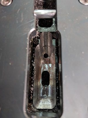

Chip management is always ongoing through the entire drilling/milling process, you can see here that they just keep piling up and you need to clear them constantly.
And now I have completed milling my own 80% Arms Lower using the Gen 2 Easy Jig. Here is a look at how it turned out.

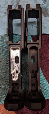

Here it is compared to an Aero Precision Lower.
Here is a weight comparison of both lowers. The Aero Precision Lower weighs 246 Grams while my finished 80% Arms Type III Hard Anodized Billet Lower weighs in at 258 Grams.

I have done 2. First was fine, second a disaster. As for chips I modified a shop vac and plug it into hollow locking nut in rear of jig. Second was the bit. It got pretty rough during the second lower and definitely did not cut as well. Lastly I got cocky/careless on second one and on one of the last adjustments to the cutter screwed up, entirely on me. It is a tedious job and requires full concentration, I learned the hard way. But glad I did it.
