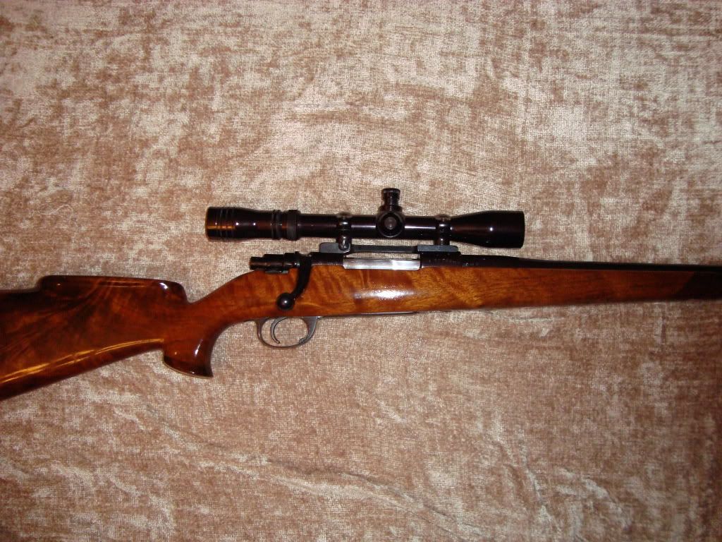

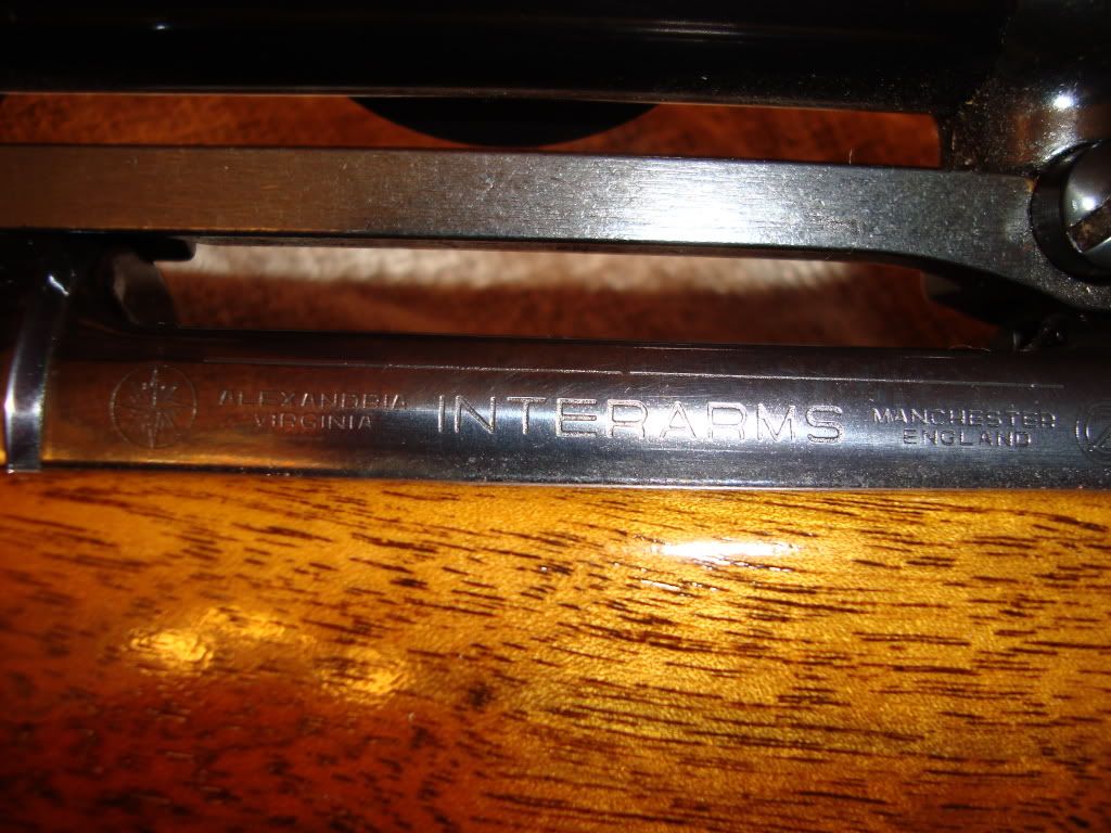

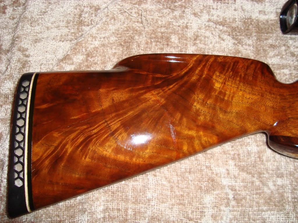

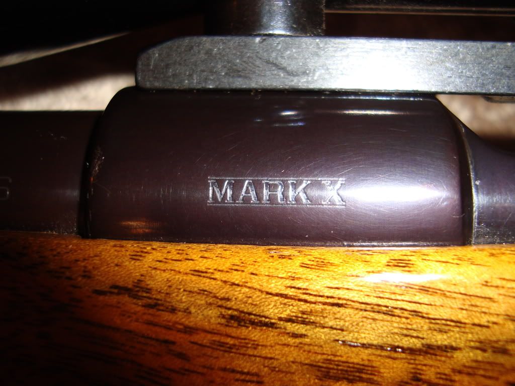

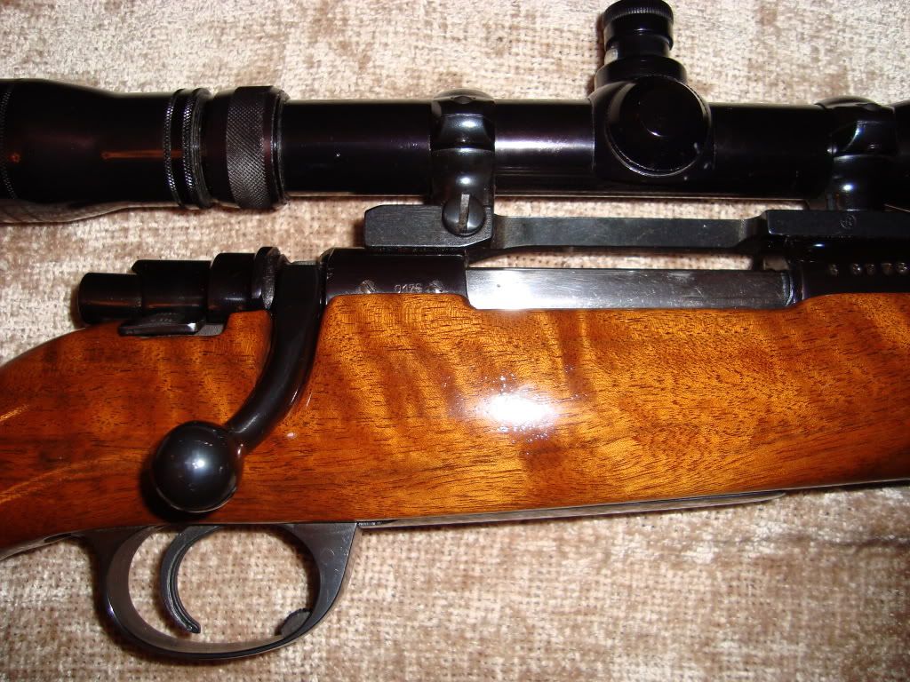

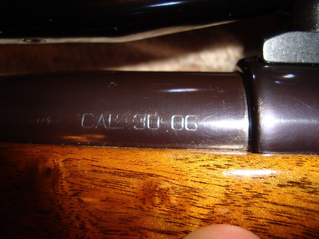

My father passed away last year and the one thing I wanted most from his legacy was this Interarms Mark X. A guy in TX custom made this Interarms 30 06 for him in the 80s. I am going to have a local gunsmith do a trigger job and mount new scope, rings, and bases. I am looking to put a Bushnell Elite 4200 on the rifle. I'm hoping to get it up and running to use as a hunting rifle in begnin conditions only. Does anybody have much knowledge on this rifle? I know they were made in the former Yugoslavia. This is truly a beautiful rifle and my father killed a pronghorn antelope out in WY with it and honestly that is probably one of the few times it was ever shot. Here are some pics.

Those are good rifles and that is a beautiful piece of wood. Enjoy, and good luck.
They are basically commercial 98 Mausers made in Serbia and Montenegro. The one you have is obviously one that was imported as a Mark X by Interarms back in the day.
During the 90's due to economic sanctions being placed on Serbia during the Balkans War, they were no longer importable until the sanctions were lifted. Once trade normalized, KBI started importing them again under the Charles Daly name. Remington up until a year or so ago began importing them and called them the M-798 and 799 (mini-Mauser).
EAA is the importer now. Sad part was that once Remington and now EAA started importing them, they dropped the left-hand Mausers and mini-Mausers.

This rifle should meet all your hunting needs. As for changing the bases, yes, a two piece base would be more attractive but the one piece base is stronger. Unless there's a compelling reason to change the scope, a 3-9X is ideal for a .30-06 but would be a bit too much scope for woods hunting.
Also, I wouldn't get swayed by the latest short-fat-ultra-belted-kill'emdead magnum. The .30-06 can do it all with less noise, powder and recoil. It can also reach further than most of us are competent to shoot. You can also find .30-06 ammo i even the smallest general store that sells ammo.

These are really great guns in stock form and yours has a drop dead gorgeous stock on it. I agree the rings and bases you have are fine and I think the Bushnell Elite 4200 is a great scope. I have a Mark X Mauser 30-06 private labeled as an H&R Model 340 made in the early 70's and it shoots easily under a MOA at 100 yards. I just refinished the stock on it because it was starting to look a little worst for wear. :D

The problem with the rings is the allen screws have turned to mush. I tried to put a new scope on it and the allen heads rounded out, so I have to take it to a gun smith to get new rings. Maybe I will keep the base. I will have the gunsmith look at it. I haven't used the Redfield scope, but I would feel more comfortable with the Elite 4200 on the rifle. I have a brand new one and I would bet scope technology has improved since the time of this Redfield. It is pretty clear, but not sure how it handles recoil and if point of impact changes with magnification adjustments. I would rather start from scratch with new rings, scope, and a new trigger job. The trigger pull is really heavy.

Would any Timney trigger for a Mauser work on this rifle? Would the gunsmith have to trim some of the stock to keep the safety functioning?
1,484 Posts
timney does make a trigger for the rifle but truth be told the factory trigger could probably be cleaned up just fine.
the one piece base is probably stronger, but it is unesessary and quite ugly... there are some very nice 2 piece bases on the market that are more than strong enough for any situation and they look much better.
