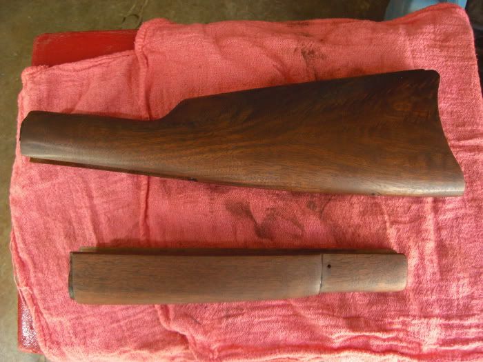

Since this gun was laying around unused and the wood had some hunting digs, I decided to play around with it. I pulled the stocks, stripped them and stained them with Red Oak Minwax. Several coats of old fashioned hand rubbed tung oil completed them. Here they are as stained before oiling.
The rest of the gun was stripped down and the hammer, lever and barreled receiver were sent off to have the markings removed and post-1900 Winchester markings rolled on. The hammer and lever were color case hardened and the caliber changed to .45-90. Now, if I can just find a replacement for that abominable rear sight. What I would like to do is find a smith to mill the bolt for a 98A peep sight.

Very nice, I love the Browning replica leverguns. Yours looks 100 times better without that epozy finish on the wood. What did you use to strip it off?
