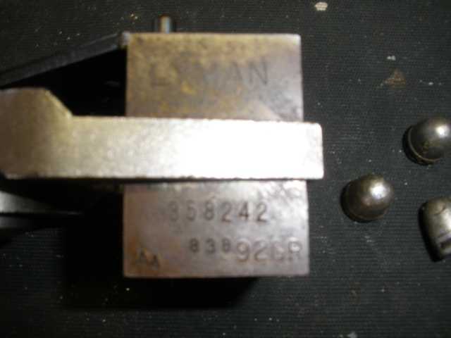

I'm using a Lyman 358242 mold for a 92 gr LRN boolit. I load 4.1 grs of Unique under it giving 730 fps out of my CZ83.
