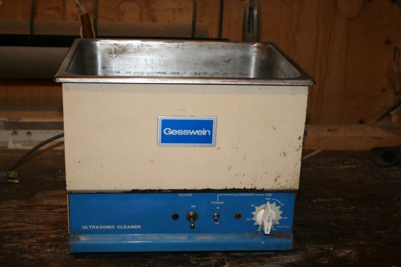

Ok I picked up my sonic machine today, and picked up some of the lemi-shine from walmart. Now the stuff I got was a powder form. I put about 2 tablespoon's of the stuff in a gallon of water, and poured it in the machine. It took about 45 min to get about 400 rounds of 9mm really clean. They did turn out looking great. The water is really dirty at this point. I suppose I should toss it and start with fresh stuff next batch. Do you think I need to put more of the lemi-shine in the next batch?????

Good looking machine SLK. Mine is a tiny Harbor Freight (made in China) one. Look, you can keep using that water for another batch or two. It's still good. But I wouldn't let it sit in the cleaner waiting a week or two for more brass.
Did you rinse the brass with clean water after cleaning?

I got my machine from a friend that does watch and clock repair. He has several and sold me this one for $75.00. It was a $700.00 machine. It has 4 transducers in it and holds about 2 1/2 gallons of liquid.
I think a mistake I made was I put the casings in plastic shell holders that they come from the factory in, and rested the plastics on the bottom of the tank. I think it would have cleaned much faster if I had suspended them in the tank.
