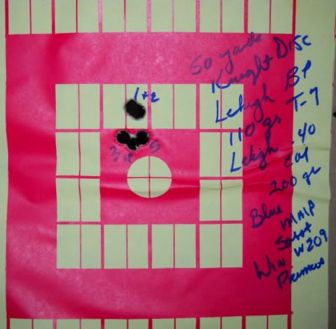

Rifle: Knight Disc .50 caliber
Scope: Niko Pro Staff 2-7x32mm
Projectile : .40 caliber 200 grain Lehigh hollow point
Sabot: MMP blue 50/40 sabot
Powder: Triple Seven 2f
Primer: Winchester W209
Distance to target: 50 yards
Swab solution: Windex Glass Cleaner
Breech plug: Lehigh Gen II with only white teflon tape as lube
The rifle was swabbed with Windex Glass Cleaner. I then popped two primers through the breech plug. I loaded 110 grains of Triple Seven 2f powder. The Lehigh 200 grain projectile in the blue MMP sabot was loaded with very little effort.
The rifle was sighted in for 100 yards. The first two hits were holding a dead center bull. The last three was aiming at the bottom of the bulls eye. I was very pleased with the accuracy of the rifle and the projectiles.
