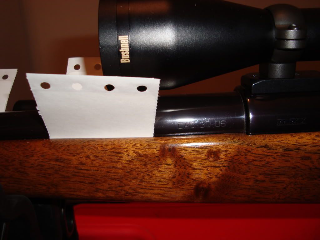

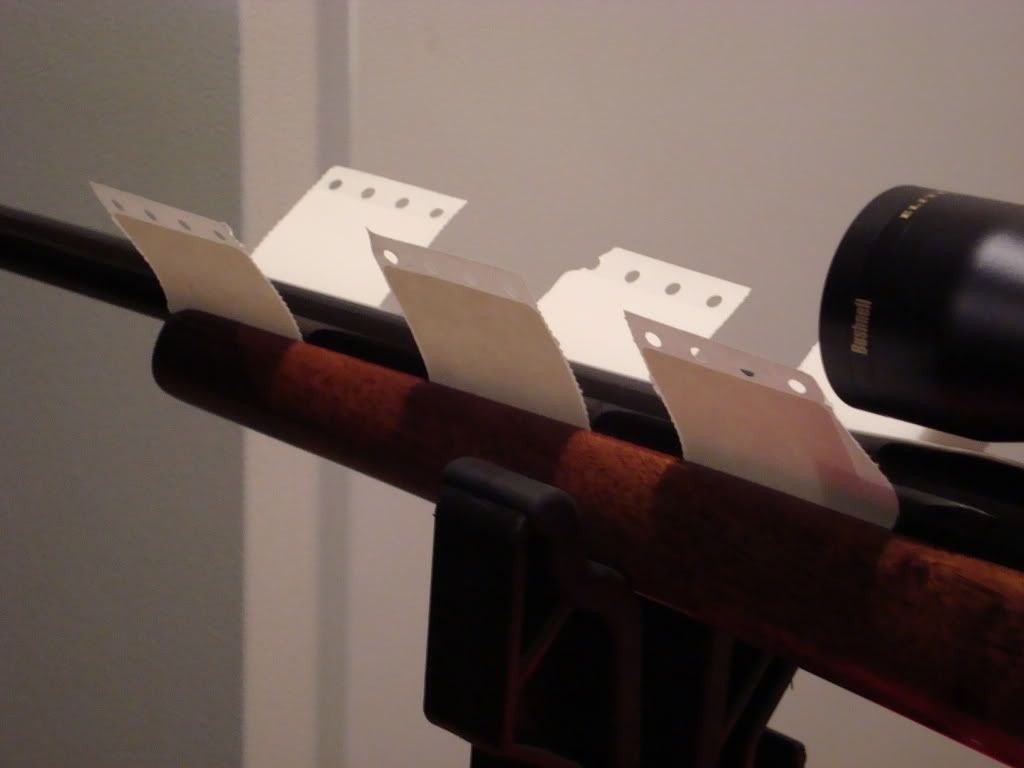

I know very little about bedding a stock and know nothing about what type of bedding job the maker of this custom Interarms Mark X did on this rifle. I guess the good thing is the barrel is free floating. I slipped some labels in three spots to see if the barrel is free floating. It stops at the fat part of the barrel. Will this enhance accuracy?

That's pretty good for a hunting rifle as far as I'm concerned. Note, free-floating does not guarantee the best accuracy. Many rifles can be made to shoot better groups with some amount of forend pressure on the barrel.
What you get in a free-floating barrel is less of a wandering zero due to the stock flexing in response to the temp, humidity, etc. If you want to see if your gun could have a zero issue if such things were to happen, add a little forend pressure and see if the groups move. Try one business card, then two, three, etc.
Chances are the zero will move a bit, and you might be surprised how much and in which direction.

I agree with Mike. For a hunting rifle you have a great set up. Good trigger, good optics and a free floated barrel. With the rifles that Iv seen free floated it does improve accuracy and I can see where a non-free floated gun would change point of impact from day to day. Iv seen some guns that are floated all the way back to the recoil lug and still didnt group as well as guns floated like yours. With the right load (or just the right factory load) your gun should shoot under 1". And if it doesnt, thats ok too. Youre shooting at roughly a 6" vital zone on whitetails so even a 2" group will do the job. Thats where the term "minute of whitetail" comes into play.
