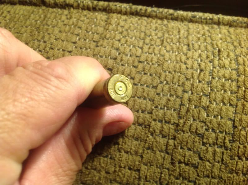

Question M100 v2.1
Okay, last week, on Monday, I called the M100 recall hotline. It took me a few tries to get through, but I did. My latest, M100, also had not been recall serviced. So, I re-downloaded the exploded view, and removed the firing pin, which promptly went back to them, the next day.
Today, when I got home, there was a small, padded manilla envelope, with a Winchester return address on it. (But, no $30 check) So, I promptly took the M100 apart, to install the new firing pin. It took a little re-figuring out, of what had to do what, to get it together, but I am happy to say, it is back together.
However, (there's always a "however", isn't there?) I just took it to the pasture, to test fire it. Loaded the mag, with three good Federal Ball rounds (want to save the good hunting ammo), and i got two misfires, with the first two rounds. Both, appear to be light strikes, on the primer. The third fired, but did not eject, nor did it show a deeper impression, in the primer. As a matter of fact, it looked lighter than the first two.
Any clues, or suggestions?

Stronger firing pin spring. www.brownells.com

Here's the fired case
Here is a photo of the one case that fired. I tend to think that it's not a weak firing pin spring. Maybe a weak hammer spring. But, a weak firing pin spring wouldn't keep it from hitting the primer hard.
  #92
Old 04-12-2014, 06:45 PM
Join Date: Aug 2011
Posts: 3,128
A weak FP Spring may not bring the FP completely to the rear. When this happens the hammer may not hit the FP with the correct force, causing light strikes.
Your Photo appears to show a Raised Ring around the Firing Pin Tip Impression.
If this is its actual appearance, it may be that you are getting Extrusion of the Primer cup back into the Firing pin Hole in the Bolt, not a 'Good Thing'.
Since you Stated that the First Two rounds failed to fire and also have what appears to be a 'Light firing pin strike' could it be your firing Pin does not extend far enough out of the Bolt face on discharge?
Alternatively, What is your "Head Space" Set At?
From What I have seen of a Win.M100, it seems to have a mix of Long and short Gas system design features. All Gas systems are prone to fouling collection so perhaps you nee dto inspect and Clean the Gas System again?
Just Some Musings on your stated problems.
