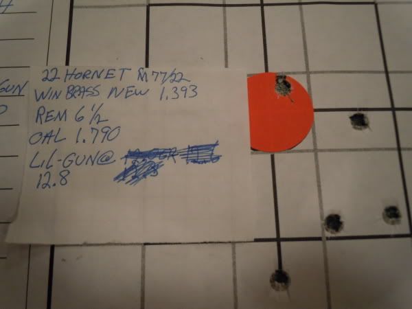

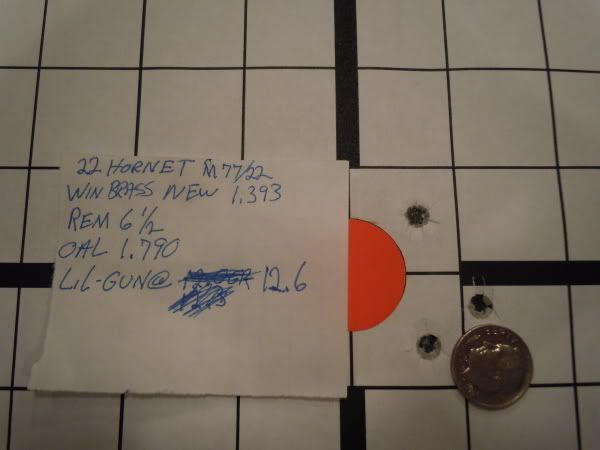

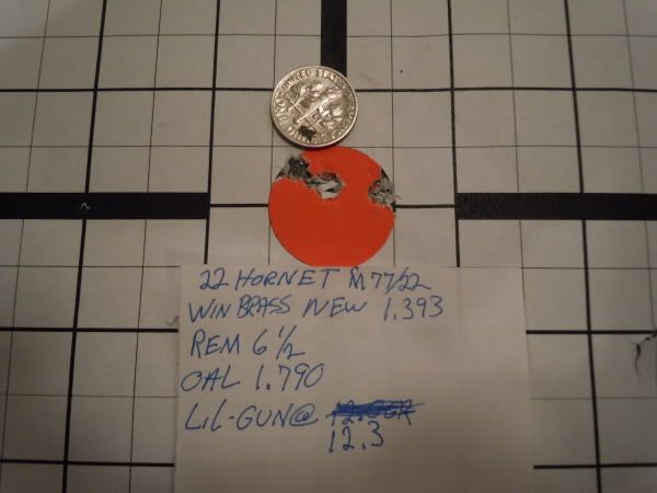

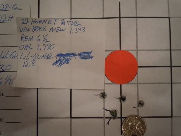

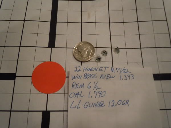

New to this forum and asking for input for 22 hornet loads. To get the basic info out of the way first. I am shooting a Ruger 77/22, 20" barrel, Nikon 4.5-14 x 40mm. Shooting set-up is front and rear sandbags, on a very sturdy bench. Range is 100 yards. For all loads mentioned the bullet is Hornady 40gr. V-max.. My normal load is IMR 4227 @ 11.3gr. CCI400, OAL 1.790.
I wanted to improve the groups I was getting, somewhere around an inch.
After reading a lot on different forums (Including here) I was interested in trying LilGun powder and Rem 6 1/2 primers..
Today I loaded up a few rounds of the LilGun. Loads were as follows. If everything works out correctly there will be pictures that follow loads.
All brass was NEW Winchester, Untouched. Just deburred to accept bullet.
Load 1: LilGun @ 12.0gr, Rem 6 1/2, OAL 1.790......After I shot this group I was thinking, Yes I'm on the right track with the LilGun powder that I have heard so much about.
Load 2: LilGun @ 12.3gr, Rem 6 1/2, OAL 1.790....POI changed but more concerned about groups size's. Again I was fairly happy so far with the group size, and figured it would only get better.
Load 3: LilGun @ 12.6, Rem 6 1/2, OAL 1.790....All 3 shots felt good. Figured i got out of the sweet spot in the load. But so soon? Load range is 12.0-13.0...ANY IDEAS?
Load 4: LilGun @ 12.8, Rem 6 1/2, OAL 1.790......Now this just blew my mind !!!...5 shots in a 2 1/2 " group?? What is up with that, any ideas?
Load 5: LilGun @ 13.0, Rem 6 1/2, OAL 1.790.....First 2 shots in the same hole, other 3, well you see where they landed.....better then load 4, but still not as good as i expected.
I understand that POI and Group size will and do change within the load development stages. I changed from my normal Primer of CCI400 to the Rem 6 1/2 because of the much read info about the primer dislodging the bullet before all the powder is ignited. I do have a Lee Factory Crimp die, but did not use it on these loads. Mainly because I have to seat the bullet farther into the case so it will feed in the M 77/22 magazine. It appears that if I were to use the FCD it might crimp onto the Ogive of the 40gr. V-Max. I tried the FCD before on loads and didnt see that much of an improvement, if any at all.
Your help and suggests will be greatly appreciated.

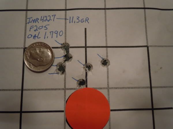

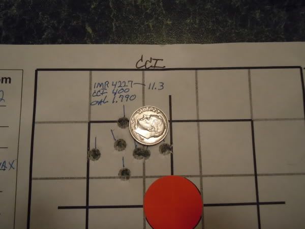

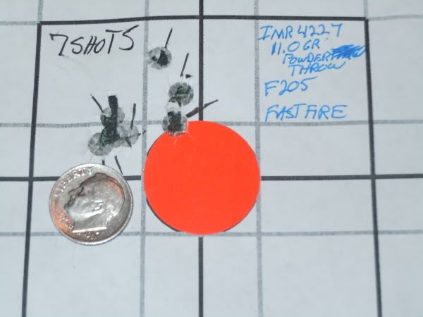

The following pictures are my normal loads (IMR4227,11.3gr.) with the change up between CCI400 and F205. I am going to try them with the Rem 6 1/2 next time....
CCI400
F205

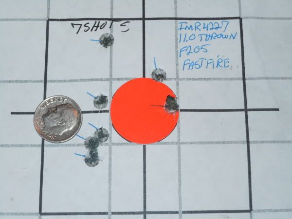

Then I had some loads that i used a Lee powder throw to charge, IMR4227 @ 11.0gr., F205 Primer.
Faster rate of fire for these rounds.
Sorry for such a long post, but figured the more information I put out there with pictures to confirm the range results, the better information I'll get back in return.
Kevin204.

First, welcome to the board, Kevin.
You may have to switch to a blunter bullet. Rugers just aren't compatible with tipped bullets because of the magazine. Your seating issue shows that. Sierra makes a very good Hornet bullet in both 40 and 45 weights. They are blunt enough to seat and feed in your gun.
None of your groups are that bad, really. Single groups in any load combination don't prove much; you can have a random good or bad group with any load. I think that with a bullet change and use of the LFD, you are on the right track.

#5 · (Edited)
Thanks for the suggestions and the welcome.
I do have some Sierra 45gr. spitzers (Sierra #1310) in the cabinet that I will go ahead and try with the LilGun load. I'll also use the LFD and see if that helps.
How much compression is normal when seating a bullet in the hornet. Seems like there is less of it with the LilGun powder then with the IMR4227. The IMR4227 leaves about .100 free space in the case, and the LilGun there is about .130 free space. I did in fact use the "swirl method" of charging the case with powder, and I can say that it really does make a big difference. I actually did a little test to see how much it actually changed. I filled a hornet case right to the top (measuring spoon level), weighted the charge and it was at 13.7gr., then swirled that powder into the case and topped of the extra space that was left. Weighted the charge again and now it was at 14.2gr., swirled that charge back into the case and it was just about full. WOW, what a difference that makes in small cases. I picked up on that little trick while lurking in the shadow on this forum before joining.
I'll test out the 45.gr loads and get back with the results hopefully soon.

I don't crimp the brass in my Ruger M77/22 Hornet. As Rocky advised, the necks are only sized down about 1/4", just enough to put tension on the bullet. This leaves a slight bulge of unsized neck that helps in seating in the chamber.
The 40 gr V-Max is loaded with 12.0 gr Li'l Gun and 1.765" COAL. A CCI 400 BR primer is used. This load produces groups in the area 0f .750", which for a Hornet, I consider pretty good. Some advocate using the Small Pistol primer, but I haven't found this to matter much. If you're having flattened primers now, the softer cup of a pistol primer will greatly increase this tendency.
Save
