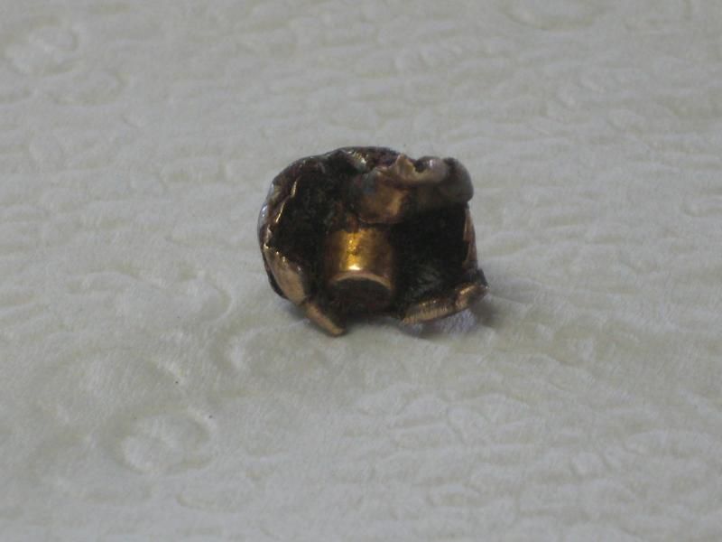

The Hot-core is in actuality a "bonded" bullet since the core is molten when applied, it in effect "solders" itself to the jacket. I have no experience what-so-ever with the Hot Core, but I do have with the SPBT.
I chose the SPBT (85 grain) for my .243 as a prime mule deer and antelope bullet. I was not disjointed with it's performance. Here's one recovered form a Montana whitetail last fall. With blood 'n hair it weights 64 grains.
From my past experience using their 180 grain version in my 30-06AI many years ago, I'd say it's a winner.
Bullets can be over constructed too. Keep in mind your initial and impact velocities at the most likely range you will be harvesting animals at and pick the bullet accordingly.
